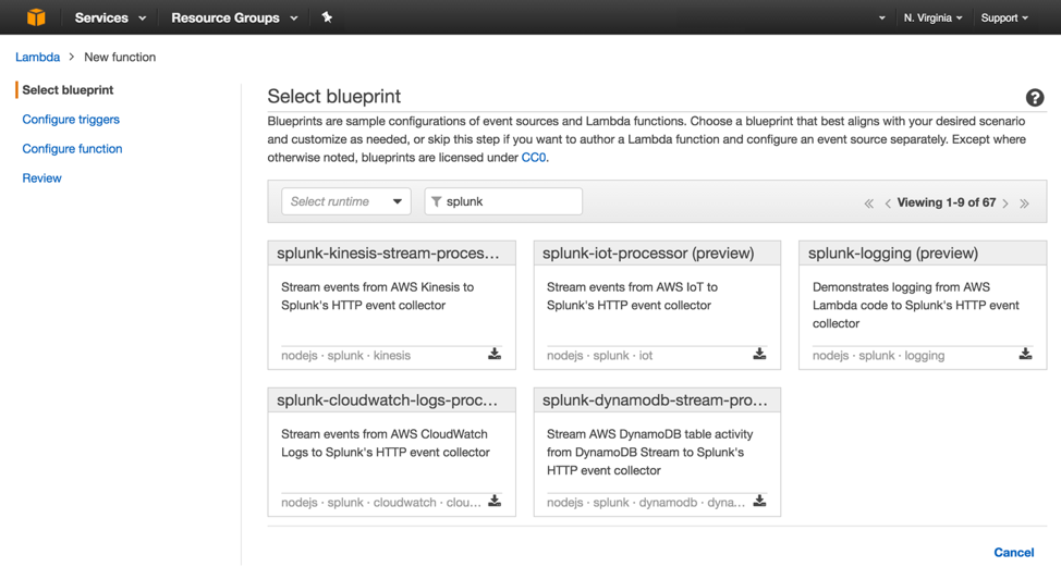

Next, you'll select the splunk-logging AWS Lambda blueprint.
Log onto the AWS Management Console, and under Compute, click Lambda.
Click Create a Lambda function.
On the Select blueprint page, type
splunk
into the Filter field, and then choose the splunk-logging blueprint.On the Configure triggers page, you can add a trigger to invoke your function, such as AWS S3 or API Gateway. Listed on this page are the various supported event sources for Lambda. Click Next for now, as you can configure the specific event source after you have configured the function itself in following step.

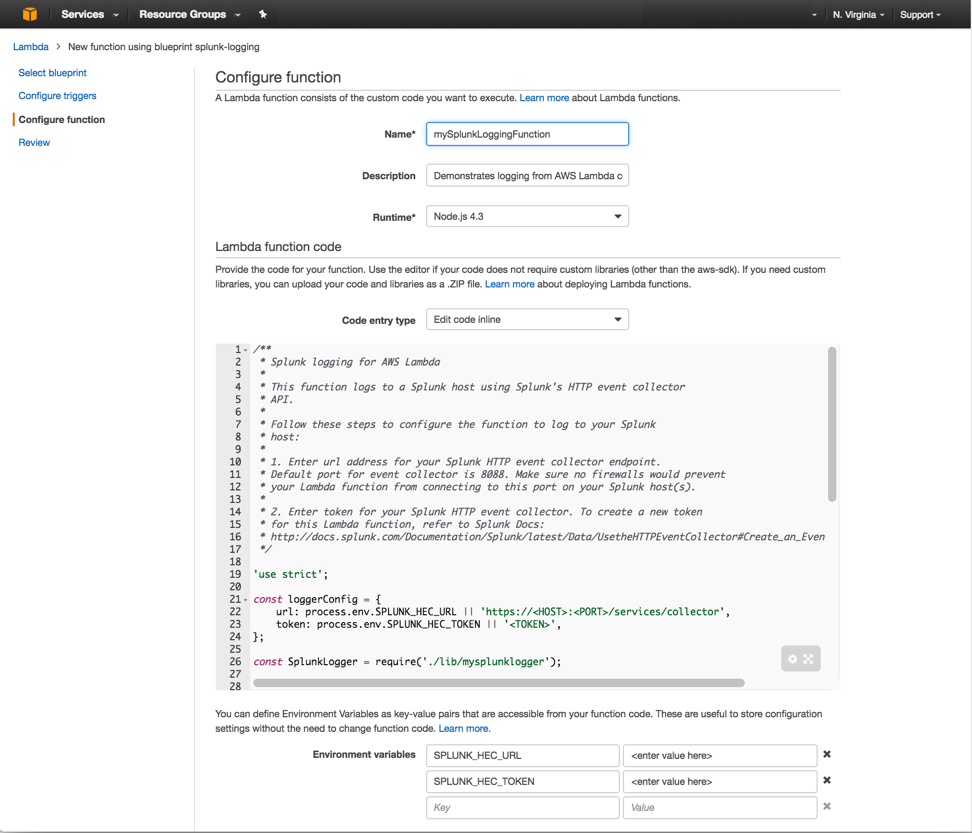

On the Configure function page, name your function. Optionally, change the description to fit what you'll be doing with the function.
In the Runtime pop-up menu, leave Node.js 4.3 as the choice.
Under Lambda function code, leave Code entry type set to Edit code inline. Scroll downward, and then set the following environment variables to configure your Lambda function:
SPLUNK_HEC_URL
: Enter the URL for your HTTP Event Collector endpoint. For example,<splunk_host>/services/collector
. Replace<splunk_host>
with the full hostname and HEC port, changing the protocol (HTTP or HTTPS) if necessary. Be sure to include the port you've assigned to HEC (8088 for Splunk Enterprise and Splunk Cloud Platform free trials, 443 for Splunk Cloud Platform), and not the Splunk Web port (8000). For more information about HEC port assignments, see Send data to HTTP Event Collector in the Splunk Cloud Getting Data In manual.SPLUNK_HEC_TOKEN
: Paste the HEC token that you created above.

After you choose the Edit code inline option, the editor appears above the Environment variables section with some pre-filled code. This code is a blueprint that sends some sample events to HEC in Splunk Enterprise or Splunk Cloud Platform. You can edit this blueprint to add your own logic.
If you examine the code in more detail, you'll see the following basic functionality.
We initially define a
loggerConfig
variable, which takes in the values of the environment variablesSPLUNK_HEC_URL
andSPLUNK_HEC_TOKEN
to set the corresponding attributesurl
andtoken
. While you can optionally hardcode these values directly inline, using the environment variables is highly recommended to avoid storing any sensitive settings as part of the function code itself.We define a logger object (
Logger
) to assemble (using thelog()
,logWithTime()
orlogEvent()
functions) and send (using theflushAsync()
function) the events.Next, we instantiate the logger (
logger
), which is immediately available upon function loading to log any event or message both during initial function load time or per function invocation inside the event handler explained below.const logger = new SplunkLogger(loggerConfig);

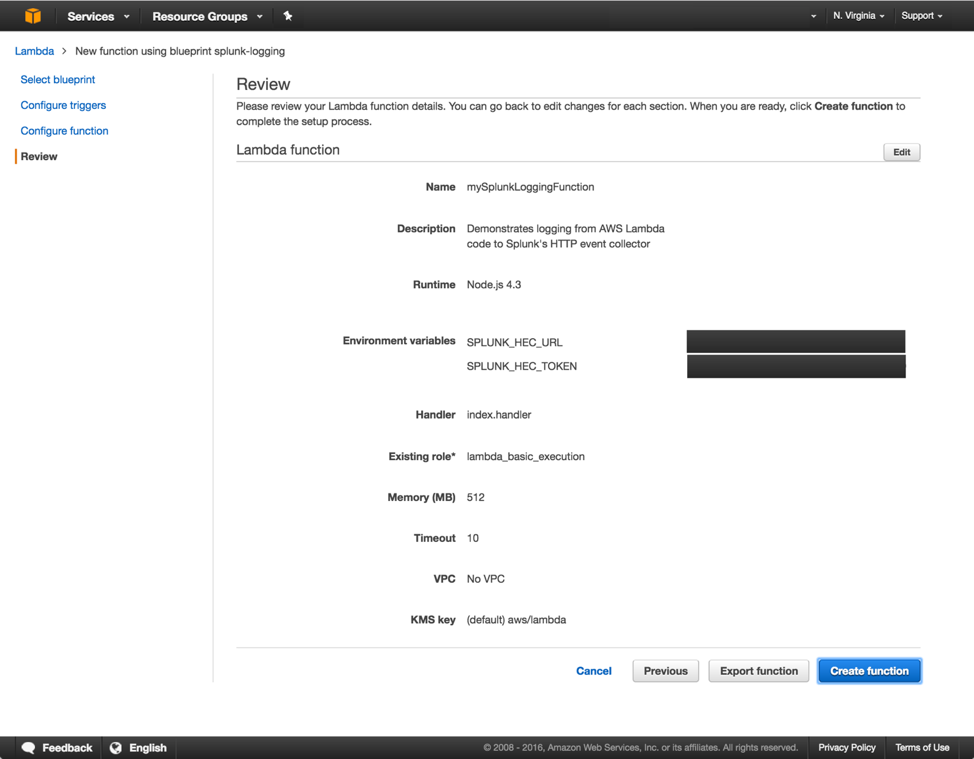

Save the Lambda function
Under Lambda function handler and role, leave the Handler field set to
index.handler
.From the Role pop-up menu, choose lambda_basic_execution under Use existing role.
Leave the Advanced settings section as is, and then click Next.
On the Review page, review your settings. If you have to make any changes, click the Edit button. When you're done, click Create function.
